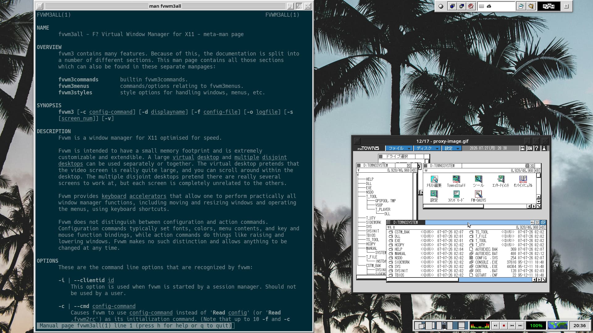

I have been using Fvwm 3 for half a year and there’s something that’s bothering me. There’s no way to get a “border under title style” (that’s shown in the screenshot). What I mean is that, when using a plain title style (Flat), there’s no way to get the bottom part of the top border to go under the titlebar.
If this where possible, Fvwm could replicate the style of MacOS 9, Windows XP and others.

example
